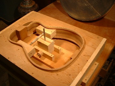

PostPosted: Tue Sep 26, 2006 5:48 pm
Posts: 170
Here's mine I just used it today.
I don't do the round and round thing. I grab the dish
and rotate it left and right. after a dozen or so times
I rotate the dish a 1/4 turn. and repeat.
the pivot pin angle adjusts to do the back taper.
Tom
http://www.moriciguitar.com
PostPosted: Tue Sep 26, 2006 9:57 pm
